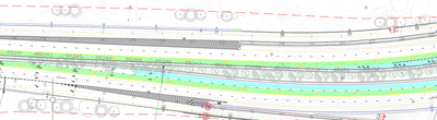

I am attaching a file that produces closed polylines that help produce accelerators, the problem is that the file does not always work well, or does not perform the operation properly, I would appreciate help in improving it and perhaps allowing it to perform accelerators in addition to closing a polyline

You need to explain more what it is your doing not just post code. Maybe a dwg before & after. Or an image at least.
Message 3 of 9
yakird6JKSJ
i design road as transportaion eng/
i need make hatch of lanes or difreent type of road elements , i add now picture as example

i opened a new drawing, draw 3 rectangles and invoke BB command and the lisp work very hard (took some time) to draw on top 3 green rectangles on layer bound. given your picture i do not see how BB can help you. BPOLY (or BOUNDARY) command can add a close pline inside a close area but you have to make sure the area is close by lines,plines (or other curves objects). BPOLY will run quickly only if you narrow the amount of objects it process (e.g Boundary set)

so do you have solutoion?
how can i create a betterl lisp that make bound polyline so it allow create hatch' ?
like the example i sent for road design , i want to create hatc for every elements ' like road/ bus lane/and more

Well, it would be easy if you make sure the area you want to hatch is well built with no gaps or if there are some small gaps, you have know what they are and set it in the allowed tolerance gaps (BHATCH command). giving that, if you know patterns you want, scale and rotation, lisp can apply this to layers but if you are looking for lisp that knows how apply hatch to un well closed area? Huston we have a problem! 😀

the lisp suppose to close open polyline and create obejcts of close elements,
i want to have close polyline so i can create hatch for all lane road deisgn
see in picture - i want for example the shoulders on lane be close so i can create hatch /lane be close so i can create hatch//
that the main purpose i want the lisp

As mentioned by others you need a closed area for the hatch, you can use this to add a closing end to 2 lines or plines.
