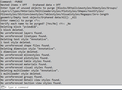

paullimapa
Enter About command do a screenshot and share that here

ec-cad
Probably due to your (command "_purge" ..... line.
try:
(command "_purge" "B" "pview$1$" "N" )
And, if you also want to purge something else, add another purge command.
For the USA, Acad versions, English, the (command "purge" "Y" "Y" "Y" "Y" "Y" "B" "pview$1$" "N" )
line will just return 'Bad Option' or something like that.
ECCAD

@info I agree with @ec-cad The AutoCAD 2024 US version does not crash and the prompts only appear when you respond Yes to Verify each name to be purged? And there is only a prompt when there is something that requires purging:
Below is the Purge command sequence when you don't want to verify:
I'm still hoping you would do a screenshot of ABOUT command so you can show if you've installed the latest 2024 version
