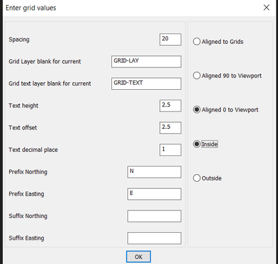

I have been messing with this code and got it to where it is almosgt perfect for my needs. One thing I can't figure out is how to have the Northing & Easting to be represented with a comma. For example: "N123,456 E1,234,567". Any assistance would be greatly appreciated.

Just an answer to your want 123,456 a couple of ways, you need to look at the number and split it, if the (strlen str) is greater than 3 so get (strcat "123" "," "456" frac) look at integer part only.
Are you doing like this.
It takes into account that mview is a rotated view.
PM me for more info.
