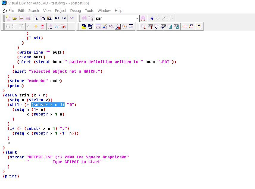

Hi, Hencoop, thank you for answering my question.
I ran debug of the Getpat Lisp as you instructed.
The result is highlighted in the code below.
Why is this happening?
Message 5 of 11
hencoop
Trim is a string handling function. x is the string and n is initially set to the length of the string. It appears that x is a null string. You can confirm this by typing x followed by the enter key in the console window after the error breaks to the VLIDE again.
