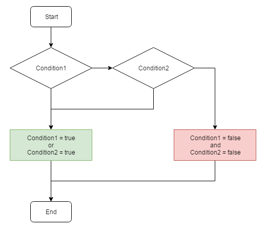

I'll try a "general reply about conditions" illustrated with some flowcharts.

Exemple 4 (short-circuiting with or):
(if (or (Condition1) (Condition2))
  (do stuff for Condition1 = true or Condition2 = true)
  (do stuff for Condition1 = false and Condition2 = false)
