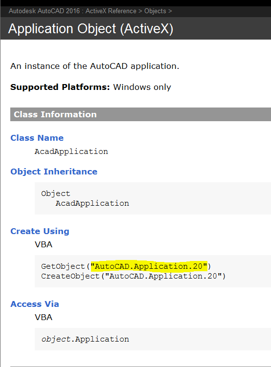

Anyway, here's the reference files to the macro
And Here's the Code

    'Get the Application object
    Dim acad As AcadApplication
    Set acad = GetObject(, "AutoCAD.Application.20")

Finally, I made it with VBA, though attributes needs a second look, but I do now have a working code that accomplish the rest.
This is thanks to the sincere help from you, @doaiena, and Randal Rath's old reply.
Check out this code.

serag.hassouna
Well, I'm using AutoCAD 2016, Can you tell me the version you're using ?
Also, try to remove the ".20" part from this line & run the code
Set acad = GetObject(, "AutoCAD.Application")
________
To specify the suitable text replacing "AutoCAD.Application.20" please refer to a file named acadauto.chm, search for it into your installation folder.
Here's where I've taken the text that worked for the version I'm using.
Message 15 of 16
jtm2020hyo
how did you solve this issue?
can you share your code?
Message 16 of 16
roland.r71
I might be wrong, as i'm (still) unfarmiliar with VBA, but the line adressed here seems odd...
What is that comma (,) doing there?
Should it not be:
Set acad = GetObject("AutoCAD.Application")
 or
Set acad = GetObject("AutoCAD.Application.20")
 as with the example given form the AKN (& highlighted) ?
