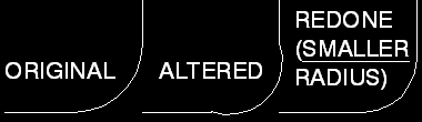

Can you provide a sample drawing or image showing the kinds of changes you may need to re-Fillet for?
Many such changes I can imagine would result in an arc segment with a different radius from the original, so if you re-Fillet the corner matching the current arc-segment radius, it will be different from what you started with.  Is that what you want?  For example, this one I altered by dragging the arc segment's midpoint grip outboard slightly:
But at a right-angle corner like that, with adjacent line segments not altered, it should be possible to calculate what the original corner radius was, and restore that.
Or are you talking about arc segments that are not changed, and all changes happening to adjacent line segments?

But....  The "same radius" as what?  Here's another possible kind of change -- the left one is the original, the right one has had its right edge Stretched farther to the right.
Re-Filleting that right one with the same radius as its arc segment currently has would not be the same as doing so with the original radius, just as in my previous Reply.  [It might not even be possible, depending on the lengths of adjacent line segments.]  But I can't imagine a way to calculate what that original radius was, unless you can be sure of certain things about the nature of the change that has been made.  For example, in this case, if you know that a right-angle corner like this may have been stretched thus in a direction parallel to one of the line segments, and will have had only one edge altered in that way, the original radius could be calculated.  But being able to count on such limited possibilities doesn't seem likely.
And what would they want to do with something like this?
That's why I asked what kinds of changes might occur.  Some kinds could probably be handled, but some kinds would be very difficult, if not impossible, to know what to do with.
