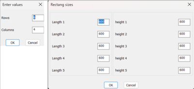

Ok need to do step1 1st label the rectangs which are lines, at the same time add to a size list. Then make table from the list of sizes sorting and counting.
I have an idea just drag over the rows of rectangs say left to right, this will get sizes. Need to do like 5 times I think much easier than trying to do some sort of XY look up.
Added to my To do list. Somebody else may jump in sooner.
Just a last comment if it was me I would do rows columns then enter sizes. So do it as one big program much easier to work with as know the size of each rectang. Adding dimensions and a table.
Message 29 of 80
Sea-Haven
Just had a play as a 1st step. Save Multi getvals.lsp in a support path. Or add full path to (load "multigetvals") Draws your line work. Next step is label.
(defun c:wow ( / ans rows col lst1 lst2 lst x colans rowans pt pt1 pt2)
(setq oldsnap (getvar 'osmode))
(setvar 'osmode 0)
(if (not AH:getvalsm)(load "Multi Getvals.lsp"))
(setq ans (AH:getvalsm (list "Enter values " "Rows " 5 4 "6" "Columns " 5 4 "4" )))
(setq rows (atoi (car ans)) col (atoi (cadr ans)))
(if (not AH:getvalsm2col)(Load "Multi getvals 2col"))
(setq lst1 '() lst2 '() x rows)
(repeat rows
(setq lst1 (cons "600" lst1))
(setq lst1 (cons 4 lst1))
(setq lst1 (cons 5 lst1))
(setq lst1 (cons (strcat "Height " (rtos x 2 0)) lst1))
(setq x (1- x))
(setq lst1 (cons "enter values " lst1))
(setq rowans (AH:getvalsm lst1))
(setq x col)
(repeat col
(setq lst2 (cons "600" lst2))
(setq lst2 (cons 4 lst2))
(setq lst2 (cons 5 lst2))
(setq lst2 (cons (strcat "Length  " (rtos x 2 0)) lst2))
(setq x (1- x))
(setq lst2 (cons "enter values " lst2))
(setq colans (AH:getvalsm lst2))
(setq pt (getpoint "\nPick a point for top left cotner "))
; do columns
(setq ss nil)
(setq pt1 pt ss (ssadd))
(foreach val rowans
(setq pt2 (mapcar '+ pt1 (list 0.0 (- (atof val)) 0.0)))
(command "line" pt1 pt2 "")
(setq ss (ssadd (entlast) ss))
(setq pt1 pt2)
(setq dist 0.0)
(foreach val colans
(command "copy" ss "" pt (mapcar '+ pt (list (setq dist (+ dist (atof val))) 0.0 0.0)))
; do Rows
