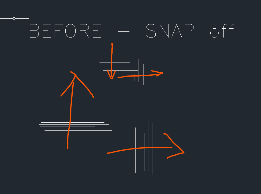

just one last request more (if possible), can you add the "undo multiple" command and let user create 2 different no consecutive lines (4 points)? for example:
Message 10 of 23
Sea-Haven
You must draw in a L as per out in out for it to work this is required to work out the join order, doing it with variations should only reverse the way the fillets are done inside or outside as I have called them. Do not need ortho on.
Yes could add a num question say 4 means 1st 4, -4 means last 4.

(setq pt1 (getpoint "Pick outside"))
  (setq pt2 (getpoint pt1 "Pick inside"))
  (setq pt3 (getpoint pt2 "Pick inside"))
(setq pt4 (getpoint pt2 "Pick outside"))
Do only 2 etc press f3 so snap off zoom in cross 2 lines cross 2 lines all done no code edit required.
