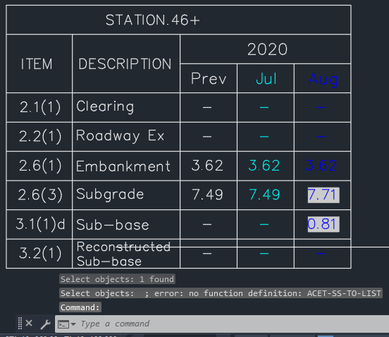

Dear all,
Now I am using the lisp (T2E) to export value list of texts in CAD to Excel. Normally it runs OK but sometimes the error occurs and I must restart the computer to try to run this lisp again. Even sometimes I restarted computer but this error still occurred again and I can not continue my work.
I really need your help to fix this problem. Please review the attached lisp and video with error for me.
Thank you so much and best regards.

Message 2 of 10
Ajilal.Vijayan
Looks like the Express tools module is not loaded or missing.
try the steps in here
https://knowledge.autodesk.com/support/autocad/troubleshooting/caas/sfdcarticles/sfdcarticles/expres...

Message 5 of 10
hosneyalaa
Capture.JPGHI
Message 6 of 10
minh.dxuan
Hi @hosneyalaa ,
With almost Section Drawings, I still can extract text values to Excel file but with this Station Drawing and some few other drawings, this error always occurs. I am using AutoCAD 2021. Please review the photo with error for me. Thank you so much.
Message 7 of 10
hosneyalaa
HI
TEST
;; https://forums.autodesk.com/t5/visual-lisp-autolisp-and-general/export-value-of-text-to-excel-sometimes-error/td-p/9764877
(defun C:T2E(/ FN FW I J LST STR)
(princ "\nChon cac Text/Mtext/Dimension can xuat ra file...")
  (IF (AND
(setq lst (mapcar 'entget (LM:ss->ent (ssget '((0 . "*TEXT,DIMENSION"))))))
   (setq	fn (getfiled "Chon file de save" "" "csv" 1))
   (setq	fw (open fn "w") i 0 j 0)
  (PROGN
(foreach n lst
;;;  (setq n (CAR lst))
(princ
 (cond
  ((wcmatch (cdadr n) "*TEXT")(strcat (setq str (vlax-get (vlax-ename->vla-object (CDR(ASSOC -1 N))) 'Textstring)) ";Text" (itoa (setq i (1+ i))) "\n"))
  ((= (cdadr n) "DIMENSION")(strcat (if (= (acet-dxf 1 n) "")(rtos (acet-dxf 42 n))(acet-dxf 1 n))  ";Dim" (itoa (setq j (1+ j))) "\n"))
  fw
(close fw)
  (startapp "explorer" fn)
;;--------------=={ SelectionSet -> Entities }==--------------;;
;;  Converts a SelectionSet to a list of Entities             ;;
;;  Author: Lee Mac, Copyright © 2011 - www.lee-mac.com       ;;
;;  Arguments:                                                ;;
;;  ss - Valid SelectionSet (Pickset)                         ;;
;;  Returns:  List of Entity names, else nil                  ;;
(defun LM:ss->ent ( ss / i l )
    (if ss
        (repeat (setq i (sslength ss))
            (setq l (cons (ssname ss (setq i (1- i))) l))
Message 8 of 10
minh.dxuan
Dear @hosneyalaa ,
I tried your new lisp and it run well. I would like to thank you so much for your help. Wish all the best with you.
Sincerely Yours.
