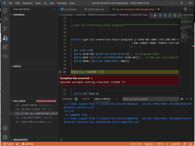

Hi @devitg that solution works great with the DWG I sent. I had to change the CLAYER value to "0" to get it to work otherwise it gave me an error.
Unfortunately I tried it on a DWG where I would use the LISP practically and it wouldn't work. I have included the DWG to this message. Do you have any ideas why?
Message 7 of 16
pbejse
(setvar 'CLAYER "1")  will generate an error as the target layer does not exists.
