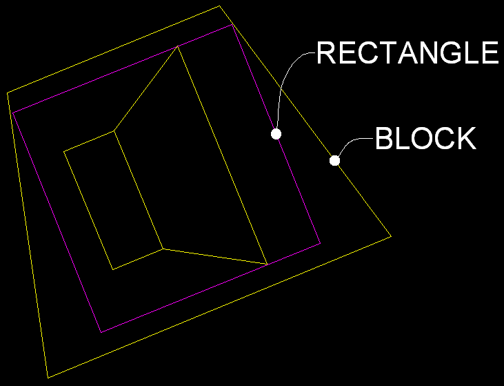

This kind of relationship?
EDIT:  Or [seeing Post 6] this?
It appears all those squares are drawn the same way, with their starting vertices in the same position.  That makes it pretty easy, if you can count on that always being the case.

Kent1Cooper
@Anonymous wrote:
The two photo are same to me, choose the one you found is easier. ^V^
The difference is that the top one has the Block insertions point [in the middle of the long edge of the trapezoid] at the midpoint of the first segment of the Polyline, whereas the bottom one has the top and bottom edges of the trapezoid equally distant from the top and bottom edges of the Polyline.  Do you have a preference?
Kent Cooper, AIA
Message 12 of 14
I prefer the one that the top one that has the Block insertions point [in the middle of the long edge of the trapezoid] at the midpoint of the first segment of the Polyline,
Message 13 of 14
Kent1Cooper
Good -- that's easier.  This is kind of basic, and minimally tested, but it worked for me in your sample drawing:
