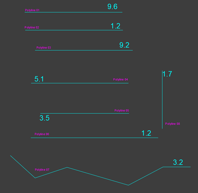

Hi, everyone
I would like to know if this is possible in Autocad
I'm on the same layer (Those are all the elements of the layer)
1. Is it possible to assign each element a factor (similar to what is in red)
2. If point 1 is possible, using a lisp to be able to add each polyline length multiplied with its factor, from all layer.

calderg1000
Regards @jorgearone_inssitu
Try this code, Select 2 by 2 text and Lwpolyline->click D, successively. Then click D, to finish. View output on the command line.

Sea-Haven
Another suggestion is select the text then look around it for a pline. Then get length*factor adding as you go.
There is many, many examples of get text and look for an object. The method is say to make a little box based on text point and see if it crosses a pline. I uses ssget "F" listofpointspline plinefilter.

jorgearone_inssitu
Thanks for the code, if it's very useful and practical, I'm going to use it, only this would be done manually.
My question is more about whether it is possible to assign or define a factor to an element (such as the polyline) intrinsically, by default, or indirectly. In such a way that the lisp can do the mathematical operation automatically, without having to be picking points in the plane.

jorgearone_inssitu
Thanks for the suggestion,
Do you think you can give an example?
You say that the lines could be crossed with the text?
And from there the code could intercept and identify them.

calderg1000
Yes of course, with XDATA, a factor can be attached to the polyline, entering a real number and it can be recovered with XDLIST. Then only the polylines would be selected and the product would be done internally automatically. With a little time I will try again later.

Sea-Haven
This is an example of get 1 pline next to a text. you would get all text and run in a loop getting a pline then the length of the pline then * (atof txt) to get the answer you want. The 10 in the polar command is a distance change to suit.
