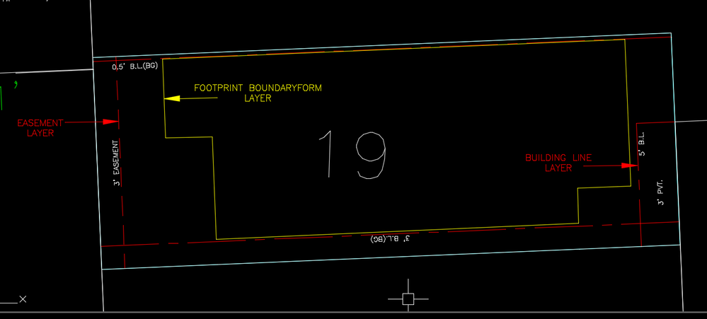

So i've been pondering the idea of creating a lisp were it detects if any line intersects or goes over a certain layered lines. For Example If a house goes over a easement line or building line. Maybe it can zoom in or does the red circle were it intersects. like when you are trying to hatch and it cad doesnt let you because the space isn't completely closed. Any help will be gratefully appreciated.

So what i want to achieve is if some one can help with  a lisp so were it can it detect if the "footprint boundary form" layer line goes over the "building line" & "easment line" laye lines. Kinda when it detects when your trying to hatch something but its not closed. EXAMPLE.png

But a footprint is allowed to touch  and/or lie along  a setback or easement line, right?  [As it looks like yours might  along the top edge -- can't quite tell from an image.]  It just can't cross over it  into the easement or setback?  That makes it far more complicated -- looking for intersections will find touching and lieing-along just as it will find crossing, and differentiating between the two would be a difficult task, though it may be possible.

Just my 2 cents worth , but if the line is along then the intersections should be at a vertex and any intersection point should also be a parameter of both lines. If it's not its crossing.

I assume you mean the intersections should be at a vertex on the building-footprint  Polyline [if that's even what it is], as in the OP's original image if that upper footprint edge does lie along the setback.  The intersections between the two obviously don't  lie at vertices on the setback  [if that's also a Polyline], so you must be talking about the footprint.
But checking whether an intersection lies at a vertex on the footprint is not necessarily a valid test:
Here, with no violation of setbacks, (intersectwith) methods between the setback lines and the building footprint would include point A, but that is not  at a vertex on the building footprint.
When Arcs or Polyline arc segments come into the picture, more possibilities that don't fit your description can occur, with intersection points that are not at a vertex on either.

Construct a polyline of the setback lines and find its area. Do the same for the Building. Get your intersection points. If there aren't any its inside. If there are intersections convert both polylines to regions and do a union. If the setback area increases, part of the building lies outside. If it doesn't the building only touches the setback line.
Alternatively subtract the setback region from the building region. The resulting shape (if any) will be the part of the building outside the setback.

I just tested.  vla-intersectwith does not return any intersections of collinear (sp?) lines.
Therefor, if they cross then there is an intersection.
Three observations:
1.  It would be less programming effort if the footprint and the setbacks were both closed polylines so that only one intersectwith test would be required between two objects, but that's really no big deal.
2.  It would be wise to make zero-elevation copies of the objects before testing.
3.  Be sure to use acextendnone (0).
