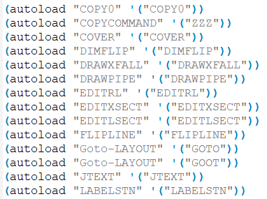

Sea-Haven
For autoloads I use a lisp with all my usual lisps in it that I know I want to use, mine is called "autoload.lsp", you use Appload and save the lisp file to the Startup suite, much easier than to acaddoc.lsp. Also inside that custom lisp is use of the function "Autoload"
The advantage is that the lisp is loaded when you type that command name. So it is not loaded till you actually need it.
Note I have my support paths set with a few directories so the lisp will be found by a simple name.

Message 33 of 36
mruPRQUJ
Hi there,
Could you please tell me more how to use it (Autoload)? What is the difference between "copycommand" and "zzz" in your Autoload lisp? I created one, but it did not work. The below is my Autoload lisp, many thanks. 🙂
(autoload "bfind" '("bfind"))
(autoload "aset" '("aset"))
(autoload "BCH_H_Reporting" '("BCH_H_Reporting"))
(autoload "cpy2lay" '("cpy2lay"))
(autoload "ctabs" '("ctabs"))
Message 34 of 36

Sea-Haven
Are the lisps in a support path ? I have all my lisps in supported directories. For Acad have trusted paths as well.
Maybe zzz and copycommand are the same, forget when I set these up, I have "goto layout" twice as I always type goto as goot so just traps that.
Message 36 of 36
mruPRQUJ
Hi there,
