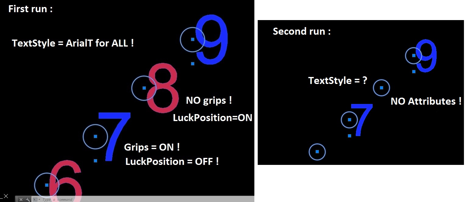

Hello everyone !
I am trying to define a block with attributes with LockPosition = On , using DXF codes (280 . 1)  and AutoLisp (lisp c: TestPP attached below ) . For Visual Lisp , property LockPosition = Read Only , so can't be changed !
The problem is , this (280 . 1)  is having effect only if I introducing codes 100 in blue . But then , I have a problem with TextStyle (7 . "ArialT")  .

I create a condition which is alternating the insertion of the attributes .
Open a new dwg , load and run the lisp . The only difference will be too many grips for blue and odd numbers , because (280 . 1) is not having any effect .
Delete all and run the lisp again . Only the blue and odd attributes are visible .
For a manual insertion , TextStyle for attribute is Standard .
So , at the same time , the same block can have different appearances / properties as : color , height , layer rotation , etc .
If I keep the TextStyle ArialT preserved in the drawing , as current Text Style or used somewhere else , are NO problems .
Any idea ?

Message 22 of 61
Hello ,
I have attached 2 pictures from Block Editor  with Attribute properties :
First one , is BA 21.jpg , for the first run of lisp , where everything is fine .
The attribute is visible and the TextStyle = ArialT , as should be ;
The second picture , BA 22.jpg , it is for the second run of lisp , when the attributes have a problem . How can be seen , even in the definition of the Attribute , the TextStyle have a problem , is not appearing in the Properties pallet .
So , in the second time , the definition of Attribute from Block pxT , it is wrong .
Seams to appear a conflict between the TextStyle AriaT and Attribute definition .

The post is about a block with 1 Attribute , TextStyle =ArialT.
Somebody else understood to align the attributes around the point . That is not an issue for me . I can do that already.
Again,  the test program is TestPP and the visibility of his Attribute in the second run of the lisp, is the issue .
The font is Arial.ttf .

Moshe-A
you mean the second time i run the lisp the issue is that the attribute is not seen?
Message 27 of 61
Yes, that it !
Message 28 of 61
Moshe-A
i ran the lisp on "BA 2.DWG" (with PxT block)  5 times (one after another) and it insert the block 50 time with not issue (or i still do not understand what is the issue here???)
Message 29 of 61
Open a new dwg  . Load and run the lisp TestPP. Delete evening and run again.
Then , the red attributes are not visible.
This is the problem.

Hello moshe ,
1. unfortunately , you need to use ALL 100 codes in red , as in my post , and then , (280 . 1) will have effect .
(100 . "AcDbEntity")
(100 . "AcDbText")
(100 . "AcDbAttributeDefinition")
2. I think you are using a different lisp for c:TestPP , see below :

And (280 . 1) will have an effect . Picture attached with results .
