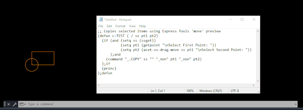

@tcoley95E9Z wrote:
...one thing I hate the most is either I need to define a getpoint to insert in which the preview of the block isnt shown (like normally grabbing a block and inserting from insert tool) or I need to do "-INSERT" where it forces me to scale and rotate...
If you have Expresss Tools installed (most people do by default), then you can use:
(acet-ss-drag-move ...)
It's a great express tool! (confirmed it works in 2023, probably older versions also)
Worth noting that you would have to do some prep work to be sure it runs correctly (i.e. making sure the block is in the drawing, make sure the block is inserted already, and create error handler to delete block insertion if user cancels/exits during the drag-move operation)
Best,
