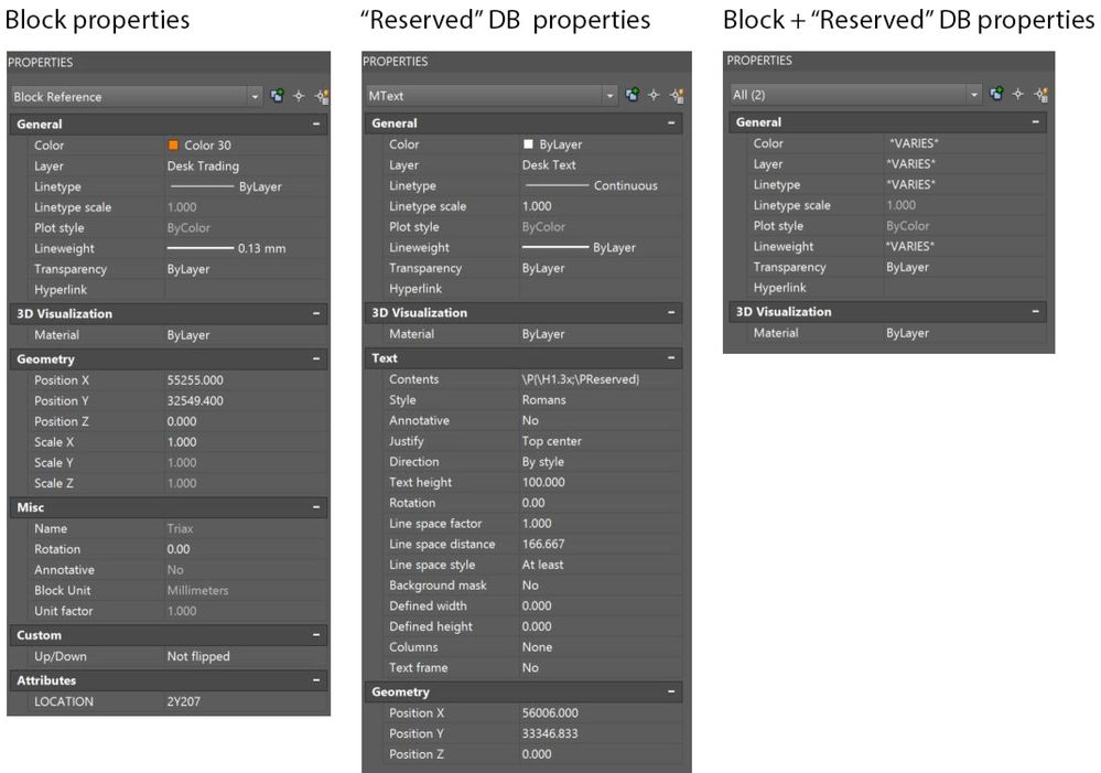

Jeanette_A
The process is this:
I add the desk block to my floorplan and once added:
1) insert block Edit Attributes prompts me to give the block a desk number (as mentioned, this is for dataextraction purposes)
2) in this scenario I edit the text from 1000 to GB350. This is then reflected on the desk.
3) I open the dataview in DBConnect and find the relevant desk and link it
4) the desk is now linked and marked as reserved according to the database ("reserved" (which is lastname) is the only information I extract from the database)
Perhaps you understand the process better with the image and description above, and how the procedure is done + how the linkage works.
The desk and the text is definitely linked but I can't physically see the connection. I think this might be the key to write the LISP code...?

DannyNL
Hi Jeanette,
Please check your PM.
If you are OK with the possible solution I'll post it here as well.
Message 18 of 20
DannyNL
@Jeanette_Ahas send an example drawing with the specified block.
In the example the desk and the text containing the name/reserved are two separate objects, a BLOCK and a MTEXT. The two objects are somehow connected as when you move/copy the desk, the text is moved/copied with it. But both objects can also be manipulated separately, so i.e. erasing one doesn't erase the other. Furthermore the desk block does contain one attribute with the tag 'location'
To solve the recoloring issues, the code makes the user select blocks with attributes only. It will then step through each block and look for an attribute with the tag 'location'. If it find such an attribute, the lower left and upper right of the block bounding box is used to make a Window selection on texts containing the word 'Reserved'. Only if the selection succeeds, the block will be recolored to white.

Message 19 of 20
Jeanette_A
Hi Danny,
Thanks a lot for the code provided! I have been able to test it and it works absolutely fine - exactly what I was after!!
Now as I've got the base code working, I can easily add more functions to it and tweak as necessary.
