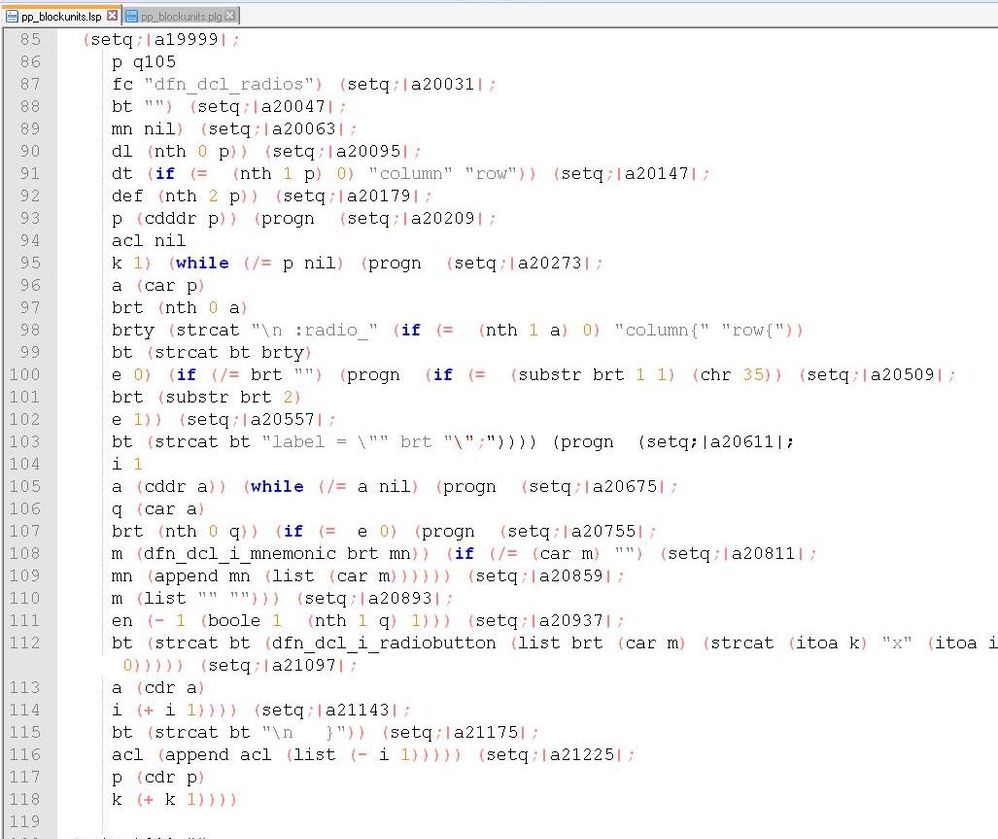

Hello.
I clone the WindowsPreInstallationEnviroment from Winre.wim-Windows10, to  AutoLisp.PreinstallationEnviroment your only InsideDrawing.dwg, with. For upgrade to newfeature.lsp, please you help me, i need collaborate together?
Now you can execute yourLisp only on "drawing where it was created"
I blocked myOwnLisp execute only, but only inside the "odg_anexa1_36.dwg"
If I run myOwnLisp outside "odg_anexa1_36.dwg", but inside other Drawing.dwg,
--then my program Crash(event the author cannot execute if lost the programe "bootsdi.wim.lsp")

@diagodose2009
a) Does your reply has anything to do with OP request. Is it of any help?  Any of your latest 10 replies?     NO
b) Majority of your posts are similar to this, with bunch of code that is not related to the topic, and
    dynamic gifs that are not related to anything. Any use of it?  NO
