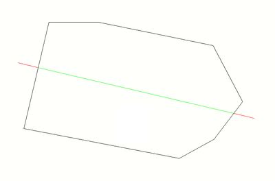

Please I Need a lisp command to create the center line on closed poly line Horizontally, And 1 meter extend from the closed polyline. For you reference I am attaching the sample dwg.
Note: green line showing the center line of the object in the dwg
           red line is showing 1 meter away from the object in the dwg

Please check my attached video, I have a lot of closed polylines and my target is create a line from center of the polyline then extend the one meter from the closed polylines.

 yes my target is draw from the center horizontally to extend the one meter from closed polyline

In his sample @ishaq03  has requested this. This is not horizontal but perpendicular to left edge and passes through shape center. So the term "horizontal" has to be taken with reserve as long as we don't receive more details from OP.

.... In his sample @ishaq03  has requested this. This is not horizontal but perpendicular to left edge .... So the term "horizontal" has to be taken with reserve as long as we don't receive more details from OP.
I agree, we need clarification.  But in their video, the result in the first case is horizontal, and not perpendicular to any edge of the Polyline shape.  [I don't understand the reason for their procedure, starting by drawing a vertical Xline, but the end result is horizontal.]  So I based my suggestion on that and the Topic wording, but asked in my last Reply about the disagreement in their sample drawing.

Hello kent, As mentioned HAK I need a horizontal line on the object along with perpendicular angle. It's a great help if you provided me  a option to extend the line as per my choice because some time it's a one meter extend  some time it's a various. Please more clarification check my attached video

hak I used the code, But line appearing on the object as a Horizontal and vertical both side and if object in a rotation angle the line is not a perpendicular and code allowing me to select one by one object I have a multiple objects which I
want to select simultaneously all only horizontal on perpendicular to object. and extension should be as per user choice which you provided me correct in your code.

In my code I have both axes of symmetry that are calculated by Acad. In case of rectangle, rotated or  not, axes are perpendicular to both edges and extended over edge for desired distance as you have in your video. Same is true for any symmetric object i.e circle, ellipse . If you want line to be perpendicular to some edge then my first posted code do that.

Nop. My first code  creates  centerline perpendicular from the EDGE you pick. So according to your first sample you would, when selecting object'  click at that point on left side edge. Made to make faster selection and explained in my original post. This becomes important when shape is not symmetric and edges are not perpendicular.  Or when you need an edge perpendicular axis that passes through shape center point (symmetric shape) or its center of mass when shape is not symmetric.
