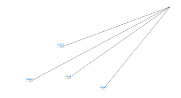

Hello!
I'm looking for a LISP, that does the following:
1. I mark blocks (usually with select similar)
2. I run the LISP command
3. The LISP creates a line from the basepoints of the previously selected blocks.
4. I can place the second point of the lines however I want (all lines end at the same point I chose)
Some other details:
The lines that are getting generated need to be all single lines, so i can delete them individually.
Here a picture of how it should look when finished:
Hopefully you guys understood what i tried to say.
Thanks in advance!

ВeekeeCZ
Here you go.
(defun c:Blines ( / s p i )
  (if (and (setq s (ssget '((0 . "INSERT"))))
	   (setq p (getpoint "\nSpecify point to connect them to: "))
	   (setq p (cons 11 (trans p 1 0)))
    (repeat (setq i (sslength s))
      (entmake (list '(0 . "LINE") (assoc 10 (entget (ssname s (setq i (1- i))))) p))))
  (princ)
thomas_schluesselberger
Thanks!
Exactly what i wanted! 🙂
