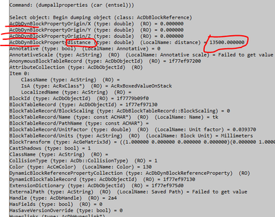

looks like the linear parameter distance is stroaged in "AcDbDynBlockPropertydistance"?  and getting this value via getpropertyvalue
how can i know how many values and its name in a block? is there any  reference manual? lol

Message 8 of 9
komondormrex
using dumpallproperties function.
(dumpallproperties (car (entsel))
Message 9 of 9
eric.ngTK42G
copy that, thx. again
