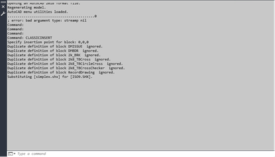

It works. I had to modify it a bit. It seems like the old border is slightly shifted to the side after I insert it, maybe because the new border has a built-in offset in the page setup manager. I didn't change it because that's how the file was set up originally.
The location of the drawing and the attributes are correct. These are the steps that I used.
- Opened the master file.
- In model space I used ClassicInsert and 0,0,0 for the base point.

When I use ClassicInsert I don’t see anything regarding the scale. Am i blind?

It works perfectly.
It stopped after 1 drawing and asked me to input Y for the UNDO command.
But I added a Y to this line and now it does all of the drawings that were in the folder.
(vl-cmdf "_.Undo" "_Back" "Y")
The only thing that it does is that it places the old border on top of the new in paper space.
