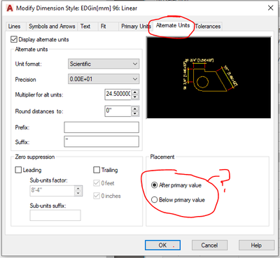

Hi All,
I want to control the placement of alternative units with a script but I can't seem to find a command for it.  Is there one?
James

Don't understand your question. That sysvar is driven by a dim style setting in the first place. Besides that, it's just a system variable that can be changed manually.
Message 9 of 10
james.levieux
OK.  Let me put that another way.  Instead of using the dialog, what are the command line settings to achieve an "over/under" alternative units format?
Message 10 of 10
ВeekeeCZ
DIMPOST
\X
