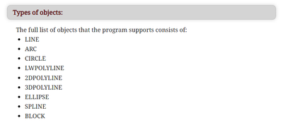

There is a commercial product out there that may do it, For Civ3D it starts as Shrinkwrap. What is its name again. Has a Train as one shape and a car engine as another.
Something like this ? Add Gaps and no idea.
Found it TotalBoundary • AutoCAD App for creating outlines of complex drawings

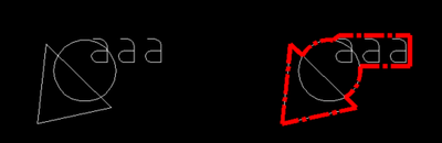

komondormrex
no whatsoever texts

@komondormrex ,
No texts?  But Alan showed a poly going around "aaa."
Alan, did you cheat?

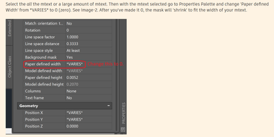

Ok may be able to do something for Text or Mtext. If you read each line and make a box around each line, then draw a dummy pline outside the mtext, then a boply will create what you want. Erase all the dummy stuff. A mtext mask exposes the 4 corners when exploded.
Ok found it so if remake the mtext into individual mtext with a frame then explode.
Ok John your turn, the method worked need a few Undo's and erases etc 😀
Will find the set to 0 for Paper defined width.
This may be a more useful way to make the boxes.
