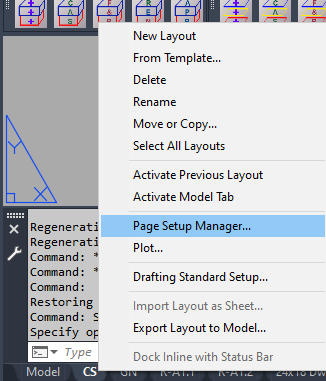

Since you added those additional layouts maybe you forgot to assign a page setup to them like the other layouts already have.
Just select one of the other previously already made layouts like CS so that it becomes current, right mouse click on it, select Page Setup Manager and it'll show you the pages setup name. Then click on each of the R-A1 layouts making them current and do the same to assign them with the matching page setup name.
