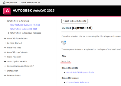

I have this line in my script :
(command "_.BURST" (ssadd ent) "")
I'm getting an error "Unknown command"
Why???

Why? Because it's not a regular built-in command. It's just another LISP function being part of Express tools.

BURST is an Express Tools command written in AutoLISP. To call it you would need to use
(c:burst)
If you are feeding items from a selection set into it as part of your script you will need to dig down into the AutoLISP file itself.

That has the same problem as in Message 1, because BURST is not a native AutoCAD command, so it cannot be used in an AutoLisp (command) function.  The suggestion by @tramber in Message 2 is the approach to take.  The way to call an AutoLisp-defined command is the (C:YourCommandName) approach.  And since that cannot take User selection or inputs or variables internally, as native AutoCAD commands in a (command) function can, you need to have your selection already selected/highlighted when you call it, which is what the (sssetfirst) function does.  [And it can be a selection of more than one object when you need that.]
