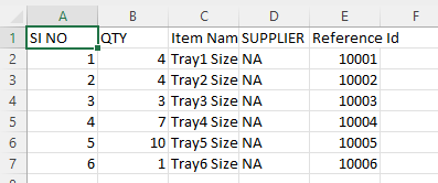

Dear All,
Please advise i have .lisp program for export the block name and qty to export new excel .
but i want automatic to write my BOQ   Excel sheet based on VLOOKUP condition .
)block name = Reference ID) so i want to fill the QTY value to excel
i want to block data inside of below excel sheet
please help me.

 block name = reference id so i want to fill the QTY value automatically from AutoCAD to excel sheet

Yes, I conform.   Reference ID is the block name in AutoCAD, I want QTY value to excel sheet automatically.
Please find the attached image for your reference. 
Thank you.

Try this, dont have excel open as it will open a blank Excel.

Message 9 of 19
ashwin-rajeshXYJW4
@Sea-Haven , Thank you so much for your solution.
I'm really surprised your given solution.   I want to just modify in little bit.
I dont want Export to Auto create- New Excel file for my data. I want to replace the QTY data only my given existing file. if selected path ( because we using standard  format )
Example: Once .lisp file is loaded
Step-1 command
Step-2 Select the Excel file( using standard excel)
Step-3 Block QTY Data replaced successfully ( select excel file into fill data only QTY value )
Thanks for your valuable helps and time.

Message 15 of 19
ashwin-rajeshXYJW4
@hosneyalaa ,
Thanks for your fast response,
Actually, I'm using my standard similar excel and CAD Blocks- Your give codes working 100% but just notified after completed progress, AutoCAD Command lines in showing error.
I want just to ignore/ hide this error, but all data filled to excel.
Thank you.
Message 16 of 19
hosneyalaa
@ashwin-rajeshXYJW4
Are you
Try lisp On the same The drawing Which is attached
Or other?
You must send the same The drawing you are trying on
I can't guess the reason
Message 17 of 19
ashwin-rajeshXYJW4
@hosneyalaa ,
Thanks for your help,
.Im used this lisp to another dwg and excel ( standard file) . I'm really sorry i dont have access to share that file.
in the dwg have unwanted dynamic blocks are presented ( that block name not matching to excel reference id ) I find this is the problem.
Please advise for this problem, thanks
i want to ignore this error message only. your give code working nicely.
Please advice,  thanks
Message 18 of 19
hosneyalaa
HI @ashwin-rajeshXYJW4
TRY

Message 19 of 19
ashwin-rajeshXYJW4
@hosneyalaa Thank you for your solution, code working very well
