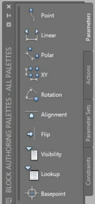

thans for always
command : bedit
I do not see the pop-up window. block palettes
What should I do to make the block palettes pop-up window visible again..
800 Views
pbejse
.BAUTHORPALETTE
You should see the toggle button at Manage Panel on Ribbons
