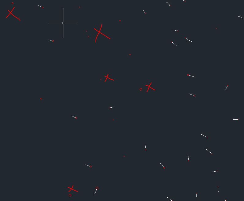

I am currently working on a project that involves several locations where I need to move the leader lines to the centre of circles. Manually adjusting each leader is quite time-consuming, given the number of locations I am dealing with.
I wanted to ask if there is an automated solution or a LISP routine that can help speed up this process by moving all leaders to the centre of the selected circles at once. Ideally, I would like a way to select multiple circles and corresponding leaders and have the leaders automatically snapped to the centre of the circles.
Any help or guidance would be greatly appreciated
