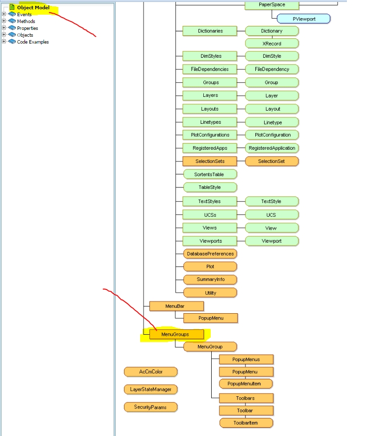

This is pretty much pseudocode; by no means a solution..  But if I were going to attempt what you want I it's how I would start..  I'm not certain if you will be able to do this in the ACAD.lsp at startup either.
(vl-load-com)
(setq tlv-mg (vla-get-menugroups (vlax-get-acad-object)))
(cond
  (;cond office a
   (= subnet? "office A");office identifier
   (if (setq Unloadthis (vla-item tlv-mg "Menu Name I don't want"))
     (vla-unload unloadthis)
     );if
   (if (not (vla-item tlv-mg "Menu Name I want Loaded"))
     (vla-load "C:\\Path\\Menufile.cuix")
     );if
   );cond A
  (= subnet? "office B");office identifier
     );if
     );if
   );cond B
  );cond
I used this website for reference:  http://entercad.ru/acadauto.en/  It may come in handy.  The blocks are all links and if you click them you'll get more detailed information on the objects and how to use visual lisp to manipulate them.

AFAIK, workspace settings control the visibility of items like toolbar objects (Which have a "visible" property that can be set with your lisp).  PopupMenus have methods called InsertInMenuBar and RemoveFromMenuBar; so after you load your MenuGroup from the file you could control how its items are shown in the menubar as well.
If you do this with lisp and the workspaces are set to automatically save it may go pretty smoothly.  You'll probably get toolbars popping into strange places at first though.
