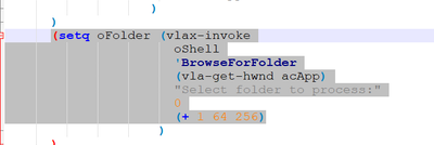

I suppose that the command in the lisp is this one:
(setq oFolder (vlax-invoke
oShell
'BrowseForFolder
(vla-get-hwnd acApp)
"Select folder to process:"
0
(+ 1 64 256)
But what I want is to go directly to the drawing directory so I can select the files quickly instead of expanding everything that's before.
Here are some screenshots
The code

Sea-Haven
Have a look at this "Getfiled"
Help: getfiled (AutoLISP) (autodesk.com)
May be a french version.
paullimapa
If you have Express Tools then the following code will work:
(if(and(member "acetutil.arx"(arx))acet-ui-getfile)(acet-ui-pickdir "Select Item" (getvar"dwgprefix") "Select Folder to Process")(alert"AutoCAD Express Tools Not Found"))
