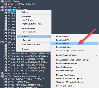

cmacdonald
Re-igniting this discussion.  I have found that the code that @Ranjit_Singh  shared works wonderfully.  However, it seems that it only works when manually initiating the PLOT (or PUBLISH if edited for that) command outside of SSM.  Is there a way to get this to work when initiating plotting/publishing via the SSM?  It seems as though that command is different, or is initiated via another route.  I don't see anything in the command line when this is plotted/published from the SSM.  ALso, I am using full ACAD.
FYI - I am extremely novice with LISP.
TIA!
Message 15 of 16
pendean
Community Legend
Community Legend
@cmacdonald LISP is not going to replace to change/edit/replace/add/remove from any core command pop-up like in your screenshot, sorry. That's going to have to come from Autodesk ultimately.
Message 16 of 16
Sea-Haven
A maybe you can Redefine commands using a lisp defun so if you type "Plot" it now runs a lisp 1st then executes the PLOT command, the other way can be to use a reactor that traps the plot command and again runs a lisp then the normal command, I have used this for Close and Save where other steps where to be carried out 1st.
