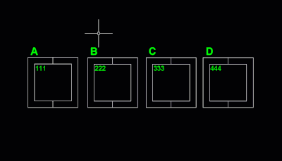

Is there a way to select multiple attributes (if possible even from multiple different blocks) via a normal selection window?
When i want to move or edit other factors i always need to select the attributes i want one by one.
So the goal is to select the attributes with a window/cross select window as the attributes would be normal texts.
If possible it woud also be nice, that the LISP is capable of selecting attributes and normal text at the same time.

thomas_schluesselberger
Hi!
I attached you a video.
The rectangles with the numbers are each a block with an attribute.
I would like to mark these attributes using window selection, so that i can change the value, widht, ...
Currently I always have to select them one by one with CTRL+left click.
Message 7 of 35

Message 18 of 35
Hello everyone!
Thank you for your efforts.
What I'm searching for is relatively exactly what @komondormrex did.
The only thing I'm not sure about is whether the LISP just highlights the attributes or whether the attributes are really selected as if I were selecting them with CTRL-left click.
Regarding the question from @Sea-Haven:
The LISP itself should not make any changes to the attributes themselves. The LISP itself should only mark the attributes. I would then like to make the changes in the quick properties.
