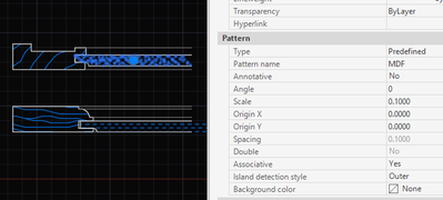

Hello, Today I was working in one drawings and I found someone else block.
When I explode the block and trim it in middle, then delete right part, it Deletes also with half hatch and hatch stays associative so I am able to stretch that and hatch is stretching with boundaries even when trimmed.
My block is stretching hatch too but once I explode it and trim, Hatch is no longer associative.
I am assuming there is some script which making hatch works differently. I Would really love to know how is this possible and how I can create something like that too.
I attached DWG to better understand what I mean.
Thanks.

ВeekeeCZ
It would be more about the block definition than anything else.
Although, not clear to me how you trimmed it to get a different result. Seem to me that both behave in the same fashion.
Edit: It seems to me that the above block was hatched by selecting the outer boundary object, while the lower block by picking a point inside the boundary.

Just did a little experimenting... So it seems, that
The first but not the only condition is that you must hatch by the Object selection method.
Second, the hatch pattern definition definitely matters. Also the angle of trimming line.
The trimming causes some sort of damage to most of the hatch pattern types. See the file - trimming by a vertical edge affects mostly the horizontal lines of the pattern. For some patterns, as your DASH, it's fatal. BUT if you change the angle to 90°, it will survive.
Even the original MDF pattern is damaged - see the (1) file - when copy-paste the trimmed hatch (colored in yellow) over the original blue, you can see that many blue dots that are not covered.

There is also this:
Command: AUDIT
Fix any errors detected? [Yes/No] <N>: y
Auditing Header
Auditing Tables
Auditing Entities Pass 1
Pass 1 200     objects auditedAcDbHatch(101EA3A)
    No Valid Hatch Boundary Loops
AcDbHatch(101EA3A)                could not be repaired.  It will be Erased.
Pass 1 800     objects auditedAcDbHatch(D1B3BD2)       Boundary Undefined             Remove Associativity
Pass 1 1100    objects audited
Auditing Entities Pass 2
Pass 2 1100    objects audited
Auditing Blocks
 15      Blocks audited
Auditing AcDsRecords
Total errors found 2 fixed 2
