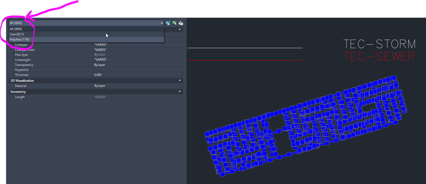

Hi Everyone,
I’m currently working on a project in AutoCAD where I need to manage sewer and storm lines within a drawing. Specifically, I need to:
  • Identify and retain sewer lines that directly intersect with or oppose storm lines.
  • Remove sewer lines that do not intersect with the storm lines.
To provide more context, the storm lines are currently coloured white, and the sewer lines are coloured red. I’ve been manually selecting and modifying these lines, but I believe there might be a more efficient way to handle this task, possibly through a LISP routine or another method within AutoCAD.
Here are my specific questions:
  1. Is there an existing AutoLISP routine or tool within AutoCAD that can help automate this process of filtering and managing these line overlaps?
  2. Are there any best practices or workflows recommended for handling this type of task in AutoCAD?
I’ve attached an example image and DWG file to illustrate the issue I’m facing.
Thank you in advance for your time and assistance.

That doesn't sound too difficult, and a little less so because everything on one of the Layers is Lines, and on the other, Polylines -- a routine could find all Lines on the Sewer Layer, and for each one, use its endpoints as a Fence to select any Polylines on the Storm Layer that cross it, and if there are none, delete it.  Is the task as simple as that?
But one significant question -- In this situation:
that one selected Line by itself does not intersect any Storm-Layer Polylines, so should it be removed [easy]?  Or because it's part of a "line" [not in the AutoCAD meaning of the word] of piping that does intersect some Storm-Layer Polylines, should it remain [much more difficult, if even possible]?
[And just in terminology:  What does it mean for a Sewer line to "oppose" a Storm line?]
A drawing with the same Layout twice, showing before and after conditions, would be helpful.
