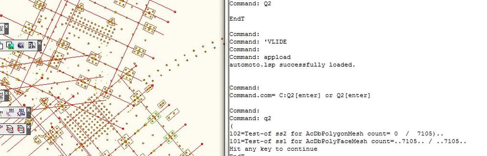

diagodose2009
Your sample.dwg is wrong,  in my Acad.exe have bug the Sample.dwg, so I can not work at your Lisp.
--to execute automoto.lsp , you run Q2[enter].
Please before, you qSave the Sample.dwg , you save as old-version (acad2010, or acad2009), because the BrisCad2022, or ZwCad or AutoCad2014, cannot detect , or AutoCad2014 have bugs in Windows11.
I make other application.lisp(name automoto.lsp), all polygon are wrongs.
