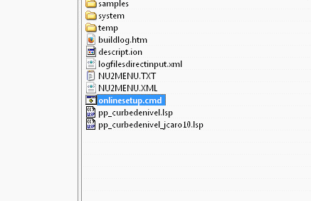

diagodose2009
My Fast Solution=You detoKenize your SourceLisp to version*.jc_aro10.lsp
After you get the error, then you type (princ setmypid) and you search C033namefunction inside Lisp-Asci.jcaro10.lsp
