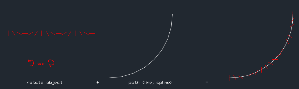

I want to align a line or block that rotates at any angle along a path(curve or spline).
the array on path command doesn't allow for rotating.
Please let me know if you have any good ideas or autoLISPs

@Anonymous,
I have a couple questions...
1) is the Rotate Object (RO) a block? series of lines? PLINEs?
2) Is the Path, when spline, at a uniform radius? or at a variable radius?
Posting a dwg of the objects in the image you provided would greatly help also.

I tried DivideMeasurePlus.lsp.
However, it rotates an angle about the tangent direction of the path,
Or they all have the same angle.
Message 7 of 20

Yes, you have both those choices.  It's the incremented  rotation option that I'm working on including in it.  I put some time into it when I can....

Perhaps this?

Yes!! that’s right.
Can I change the default angle and line length?

Yes, in (cons 10) and (cons 11) , I have put (angtof "5.0" 0) for 5° angle increment and partial_dist ("Set step to") for half-length.
You can put for exemple (angtos "15.0" 0) for 15° and substitute partial_dist by a real value; 2.5 for exemple for obtain line length at 5.0

It doesn't work well.
I want the form of inputting angle and line length in the command.

Kent1Cooper
@Anonymous wrote:
I want to use it as a block instead of a line.
Can you change it?
I had "promised" something back in Message 4, and had worked on it some at the time, but it had drifted from my consciousness, and now you've reminded me.  It could maybe use more extensive testing, but I'm posting it -- the attached DivideMeasurePlus-IR.lsp is the version with Incremented-Rotation option added.  You can do it with Points [for which Rotation, whether incremented or not, is not relevant nor asked for], or Lines, or Blocks, or any selected already-drawn object(s) -- all the choices in the original DIV+ and MEA+ commands [I did not change the command names], with all their other enhancements over ordinary Divide and Measure.
Kent Cooper, AIA
Message 18 of 20
The contents are strange.
I think there are other content.
What I want is to modify / add the last command line,
- Select objects (path):
- Set step to ?:
- Increment of angle ?:
- Length of line ?: → select block (enter block name), set center point
Message 19 of 20
CADaSchtroumpf
As I said before, I'm not a reader of thoughts ...
I gave an example of using block with attributes.
Without more precision on your part, I will consider the use of a simple block with an insertion scale of 1.

Message 20 of 20
Kent1Cooper
- Set step to ?:
Have you tried the routine attached to Message 17?  It does all that and more, except for having the selection of the path [or any number of paths] at the end.  You can choose to have it draw Lines of whatever length you choose [which will be centered on the path without your needing to specify a center point], or give it a Block name [the insertion point will go on the path without your needing to specify], or select any existing object(s), which can be an already-drawn Line, or an already-Inserted Block, or anything else including multiple  objects.  [In the case of user-Selected object(s), you do need to specify the reference point relative to it/them that will be placed on the path(s).]  You also get the choice of not only the increment  of angle, but the angle of the first one  from which that increment proceeds.  And you can do it in MEASURE-like operation or DIVIDE-like operation, with other choices that those commands don't give you.
Kent Cooper, AIA
