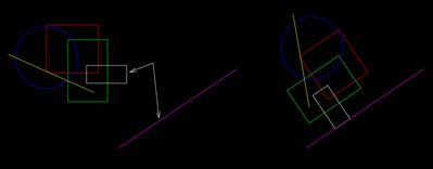

Hi everyone,
Could you help me with a lisp that:
After calling it , I will select some entities like circles,lines etc. and after that it allow to select one line from the selected entities (it also can be a line from a rectangle), and select another line to align all the selected entities to it.
like the image shown:
( and not making it a block)
Thanks.
Eyal

Message 2 of 15
Kent1Cooper
The ALIGN command will do that, easily enough -- you would just need to pick two locations along the particular edges, but it spares the need for any code.  Presumably you would need to pick two locations on each anyway, to pick each edge and to determine where on the original objects' edge should go to where on the target edge.
Kent Cooper, AIA

eyal.ch
Hi @Kent1Cooper ,
I know that the align command let the user pick 2 points on the subject and 2 more points on the target.
but what I need is by selecting only one line it will align all the selected objects to the other line selected.
I want to save the 2 clicks.
it is for quick working.
I want by only 3 commands: 1.  selecting the objects , 2. pick one line from the selection , 3. pick another line as target.
and it will align the objects.
Thanks.

cadffm
Yes, but you have to tell the program where the points L1.1 L2.1 and L1.2 L2.2 is!
I am pretty sure you don't want every time that the program use Startpoint-Line1 to Startpoint-Line2
and Endpoint-Line1 to Endpoint-Line2
One solution can be:
The User click the Line(segment) near to the endpoint what should be Point1, the program detect the nearest endpoint for Point1 of Line1 and Line2,
the other side as Point2 of Line1 and Line2.
Sebastian

eyal.ch
It suppose to be like this code :

but with adaptation, I want to select not only one object and align it , but to select some objects and by selecting a line from it , and select a target line it align the bunch of line accordingly.
this code work fine with selecting a rectangle line but not if I select a line.
Can anyone make this adaptation?

First of all, you look like you misunderstood the purpose of the Forums. We are here to help you to write your own tools, not to write it for you. For free. The complex program like you posted. BTW it has its author!! Are you allowed to post it here, are you allowed to modify it? Have you bothered to read THIS?
Anyway, here is a very simple example of how you can easily achieve almost what you want. As you can see, I have used like 5-6 different functions. nothing complicated. So stop scrounging and learn.
(defun c:Align+ (/ ss en p1 p2 p3 p4)
  (if (and (setq ss (ssget "_:L"))
	   (setq en (entsel "\nSource object: "))
	   (setq p1 (osnap (cadr en) "_end"))
	   (setq p3 (osnap (cadr en) "_nea"))
	   (setq en (entsel "\nDestination object: "))
	   (setq p2 (osnap (cadr en) "_nea"))
	   (setq p4 (osnap (cadr en) "_end"))
	   (setq p4 (polar (trans p2 1 0) (angle (trans p4 1 0) (trans p2 1 0)) (distance p2 p4)))
    (command "_.align" ss "" "_non" p1 "_non" p2 "_non" p3 "_non" p4 "" "_No"))
  (princ)
Message 7 of 15
