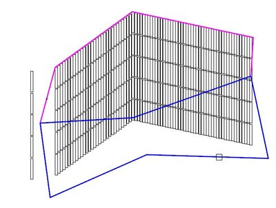

I need to distribute as many objects as possible within a given polygon.
I start with an empty polygon (closed polyline) of arbitrary shape. This gets filled with an array of objects, like so:
This distribution produces gaps around the edges which results in a suboptimal use of space. Here only 465 objects fit inside the polygon.
By pushing all objects against the "walls", I'm able to better use space and get more objects inside the polygon. For instance, by pushing all objects to the "north" wall, I'm able to fit 476 objects instead of the original 465 (3.7% increase):
The way I've done this so far is by manually selecting the objects, and displacing them orthogonally until they intersect the polyline I want to align them to.
This is very time consuming. Is there some way to do this programatically with LISP or any other method?

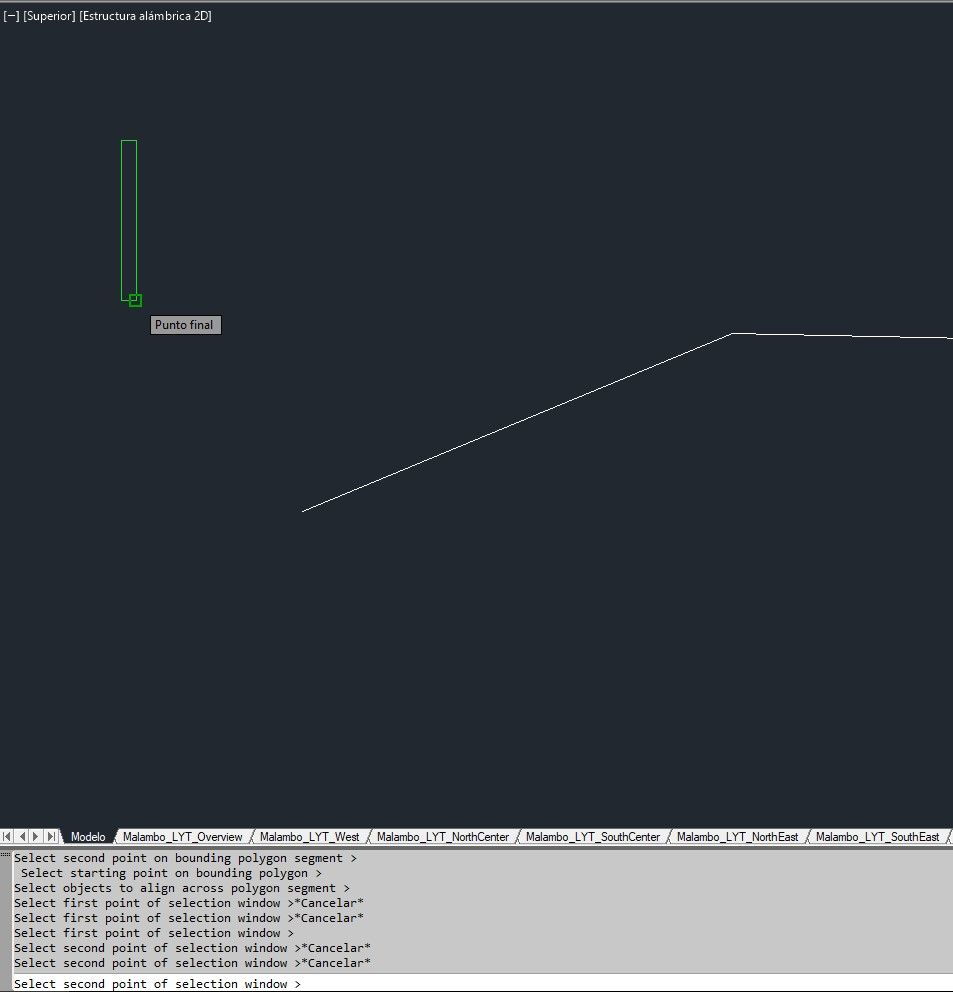

I think the issue I was having was because of a missing parenthesis after "(princ "\nType CPYALA to run command!")". After adding the parenthesis it loads OK.
I'm still not able to use it propperly - I think there's a step I'm not getting.
1) Type CPYALA
2) Input Horizontal distance: 10
3) Select first point on bounding polygon segment, Select Second Point, Select start point
4) Select object to copy (First and second window point)
Then it fails with "too many arguments".

hak_vz
When you select objects to copy dont click on them but select them by clicking somewhere aside and let selecting window enclose them. This doesent work as standard select command.
Miljenko Hatlak
Message 27 of 40
I've also tried this, but its the same. It doesnt select the object to be copied, just says "too many arguments" after I click the second point of the selection window.
Message 28 of 40

In code replace
(setq a (getpoint "\nSelect first point of selection window >"))
	(setq b (getcorner a "\nSelect second point of selection window >"))
	(setq ss (ssget "W" a b))
with
(setq ss (ssget))
First two line (setq a....) and (setq b...) should be deleted.
Miljenko Hatlak

Ok, doing that I'm able to go to the next point - it selects the object, and asks for a "rectangle corner point to align across segment" - Now after I click the corner of the rectangle I want, it fails with "too many arguments".
