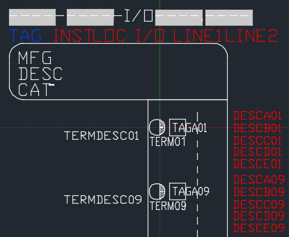

I just finish a formation in autocad electrical and i just hit a limitation.
i hope you could help.
I make a symbol library of a plc and i need to make a concatenation of several tag.
i use the autocad field command to retrive information from %<\AcObjProp Object(%<\_ObjId XXXXX>%).TextString>%.
What i understand so far, _Objld is an absolute reference of a Attribute Definition (tag).
So each time i use the icon all the field stay blanc because the field model have no value.
So two thing, first i need to update the _ObjId each time (lisp, diesel) i use the icon or there is a other methode that i cant thing or find form the internet.
here a visual of the problem.
