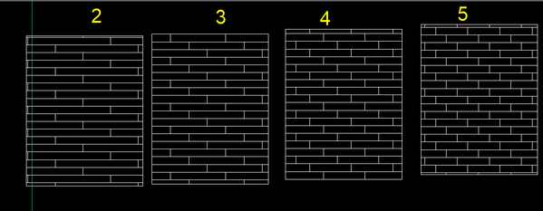

I was inspired by Kent with the other make hatch pattern so had a go at this one. Change the output directory and the default values to suit I am metric.
; make herringbone pattern offset running bond

Will fix and change name,  when are Autodesk going to allow you to edit a prior post.
As the height is fixed 72x10 the ratio comes into effect, only changing the ratio of length to next tile so the -20 is correct. 2 is mid, 3 is 1/3, 4 is 1/4 and so on.
Change to a more correct name
[You can edit your post.  They've removed the former 30-minute limit on that.  Pick the three-dots thing at upper right, and choose Edit Reply at the top.]
Your tiles clearly do not fit that "fixed 72x10" part:
Kent Cooper, AIA
