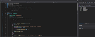

I installed visual studio 2019 (because we still use autocad 2023) / objectARX SDK 2023 / autocad.NET wizard
I created a new project using the autoCAD 2023 - Csharp plug-in
I deleted everyting in myCommand.cs and changed it by your code
But when i build this solution, load it in autocad using the NETLOAD command, nothing happens
I think i need to change some lines in your code, but i have no clue what it means
I changed this hoping it would work, but it didnt 🙂
Thomas

Not sure your knowledge level of AutoCAD .NET API. Is this your first .NET API project? There are a few reasons of "Nothing happens after NETLOAD command", but usually it should be "nothing happens", because NETLOAD only loads the .NET app dll into AutoCAD. If the DLL does not implement IExtensionApplication interface, nothing should happen until you execute one of the commands defined in the DLL (i.e. CommandMethod).
In your case, you enter "ListDataLinks", or "UpdateDataLinks" at command line after NETLOAD to load the DLL into AutoCAD. Have you done that? Or are you saying nothing happens after entering one of the 2 commands?
Norman Yuan

Thomasverbanck
Thanks for you answer.
For me its the first time using the AutoCAD . NET API.
I did load the DLL, but i didnt understand how to activate them.
The "ListDataLinks" is recognized, in the command line the datalink name is visible
The "Updatedatalink" is also recognized, but i does nothing.
I tried changing some lines, but i guess i don't know exactly what i need to fill in
What should the 'string linkName' refer to?
What should the 'string new source' refer to? => i guess the new file location?
Thanks!!!
Thomas

Norman_Yuan
The variable linkName is the data link's name when it is created, which represent a range of data of a sheet (or whole sheet) of a Excel file, in your case, if you want to manually edit/repath it, you run command "DataLink", you would a see a list of nodes underneath the "Excel Links":
In your case, according to your previous post, it should be "P01010" (or others, if the drawing has more than one data links.
And yes, variable newSource is the Excel file's full path.
When you re-path the datalink, it can be different source file with the same or different data range name, or it could be the same source file, only the data range name changes. That is, either data range name or source file path changes the data link needs to be re-pathed.
Since you are pretty new in .NET API, I strongly suggest you learn how to debug the code, so that you can step through the code line by line, not only because the code execution could run into unexpected errors, but also watch what happens as the result of execution of each line of the code, thus learn why using these code.
