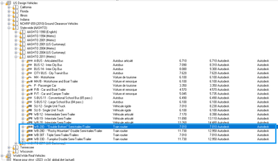

cyberflow
in reply to: Chuck_L_AKS
Just figured out how the AASHTO named their trucks :

Chuck_L_AKS
in reply to: cyberflow
Yes, this is the one I am starting with. Agreed, the AASHTO naming is quite something. However, I need more dimensions of the truck the jurisdiction specified. I have some but not enough to finish it. I guess they are popular for hauling hay. Okay, great background information, but I need more specific data.
