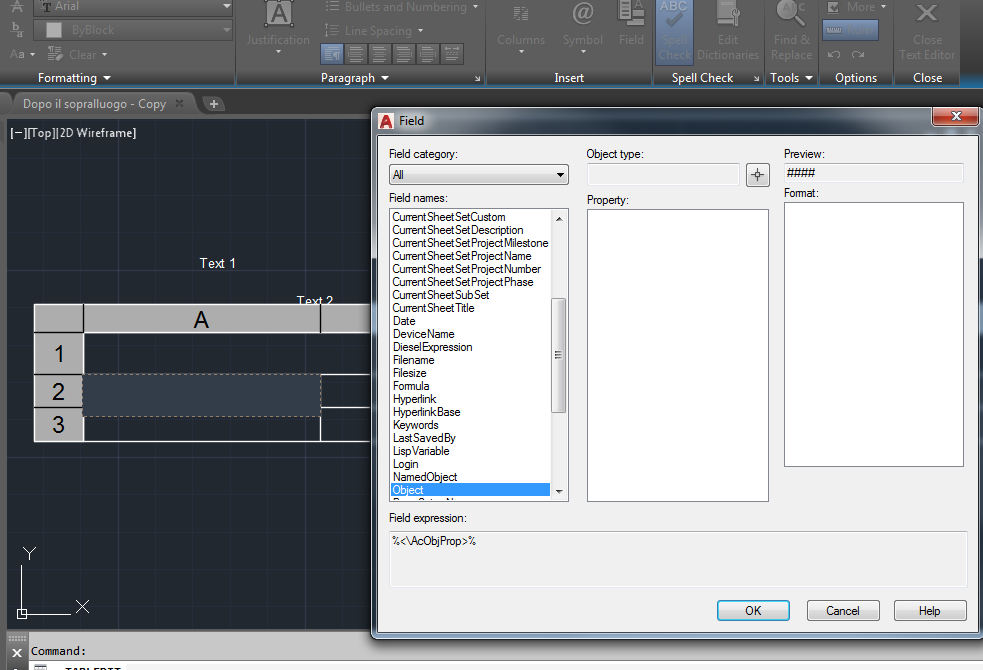

Excuse me norman.yuan,you are right.
I put also a screenshot to explain better what i want.
I want to know the VBA to create a field with a
 object to have the same text with VBA
and the VBA to create a table where the cells are the field with another objects.
[If it is possible also some examples].
The screenshots shows what i want.
Thank you very much in advance.
Francesco
Norman_Yuan
In order to create Text as field, you need to know the field code to link the text string to different values froom the other (linked) entity. You can see "Field Exproession" at the bottom of the "Field" dialog box. For example, in the case liking a text entity to another text entity's TextString, the code is
"%<\AcObjProp Object(%<\_ObjId 1094833920>%).TextString>%", where the "ObjId" number needs to be replaces dynamically in the VBA code.

As for linking Table cells to other existing text entities, you would do
1. For each table cell, identify text entity to be linked. (user picking, or based on its layer, location, text string...);
2. Once the target text is identified, compose the link code (similar as I did: replace "?" in the string constant with target text's ObjectId value);
3. Create cell content as a text as the sample code showed here (or as MText, which can be set to entirely as field, or portion of it as field)
Norman Yuan
Drive CAD With Code
Thank you norman.yuan.
You are too kind. It is perfect for text to text.
Could you do also a example for the table??^^
Norman_Yuan
OK, here is the sample code to link table's cells to text entities. It works in this way:
1. The code ask user to select a target table the code works against;
2. Then the code ask user to pick a cell in the table, which would be the first cell to be linked to text entity. Then the code starts a loop (to set each cell in next row of the same column;
3. For each cell to be linked, the code ask user to select a text entity. Once selected, its ObjectId value would be used in the FieldCode to create text in the table sell.
4. To create a Text entity in table cell is really simple by calling AcadTable.SetText(row, column, TextString). If the text string passed in is FieldCode, the text entity ccreated in the cell will be a Field.
