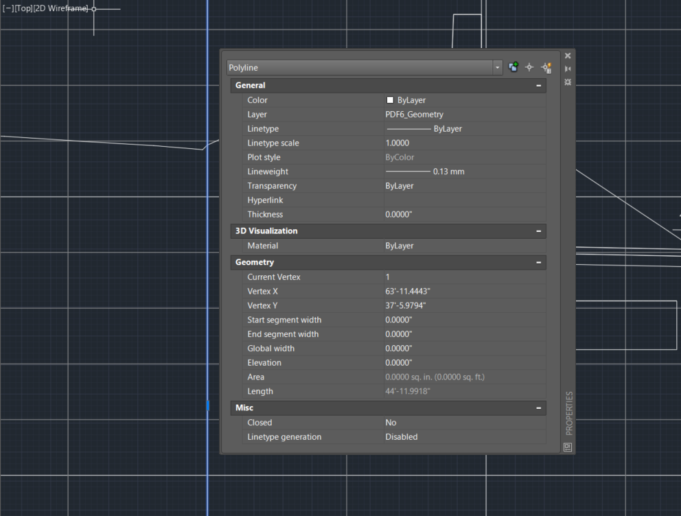

I have code below that contains the issue, and an image that shows the difference. The red/orange objects I have drawn, the grey ones have been imported. Why does the code only apply to the drawn lines, and how can I make it apply to ALL lines?

As for still not able to pick up the "grey lines", it is obvious that those "grey lines" are not individual AcadLine entities in ModelSpace. Are you sure they are AcadLines? You should be able to tell what type of entity they are by click them and look at the Properties window (or Quick Property window).
Norman Yuan
Drive CAD With Code
Message 7 of 9
All appear to be polylines, all their lengths are greater than 10, why wouldn't vba read those objects in?

It is NOT "VBA would not read...". It is the code you originally asked (AcadLine with property "Angle") ONLY do something if the entity is AcadLine with this line of code:
If TypeOf ent Is AcadLine Then
   '' ONLY AcadLine being processed here
End If
If you want process all other kinds of entities, such as polyline (AcadLWPolyline), or circle (AcadCircle), or arc (AcadArc), or whatever, you need to change the code accordingly, and you must be aware, NOT all entities have property "Angle".
No offense, but it seems that you need to study/learn a bit more on using AutoCAD to know the differences between line, polyline (and others. like circle, arc, point...) before you can correctly define your VBA's logic.

I FIGURED IT OUT! You were right, not AcadLines. Here is my finalized code, and posts I found that nudged me in the right direction. The linetypes were Lightweight Polylines. So I grabbed the AcadLWPolyLines, exploded each into a collection of objects, checked each object for AcadLine type, assigned it, and THEN checked angle, length, and performed my operation (color change). Very helpful, especially when importing lines of unknown type from vector PDF.
