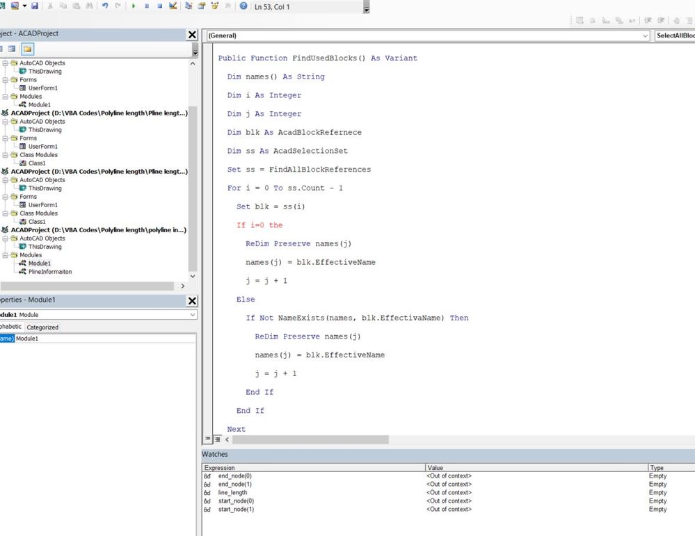

'' This function would returns an array of name of blocks that have block references inserted into the drawing.
Public Function FindUsedBlocks() As Variant
  Dim names() As String
  Dim i As Integer
  Dim j As Integer
  Dim blk As AcadBlockRefernece
  Dim ss As AcadSelectionSet
  Set ss = FindAllBlockReferences
  For i=0 to ss.Count-1
    Set blk = ss(i)
    If i=0 the
      ReDim Preserve names(j)
      names(j)=blk.EffectiveName
      j=j+1
    Else
      If Not NameExists(names, blk.EffectivaName) Then
        j=j+1
      End If
    End If
  Next
  FindUsedBlocks = names
End Function

secondly, I am a bit confused now. I have to read about the difference between an acad block and acad block reference.
I have created a shape, and used the "BLOCK" command to set that shape as a block and say I named it BL_type1
then created a second shape and named it BL_type2 and so on.
now, when I filter my selectionsets using this:
Dim block_filterdata(1) As Integer
Dim block_filtertype(1) As Variant
block_filterdata(0) = 8
block_filterdata(1) = 0
block_filtertype(0) = selected_layer
block_filtertype(1) = "insert"
block_sset.Select acSelectionSetAll, , , block_filterdata, block_filtertype
sub userform_activate()
dim bl as acadblockrefence
for each bl in block_sset
listbox.addItem .Name
next
Obviously the selectionset only selects the "insert" Items (which are acad block references) and are in the selected_layer (which i have defined it in another part). but the point is, If i didnt use (insert) BL_type1 or 2 in the drawing, it wont select it  therefore I wont have BL_type1 in block_sset
also, if I use bl_type2 or 3 or what ever, xxx times, my list will show it xxx times.
I just want to see it once.
Ill do my reading regard block and bokcreferences. Ill ask again if I couldn't come up with some thing.
and Mr. Yuan, I dont know why, but its giving a syntax error on if i=0 then...
again, thanks for the time sir.
