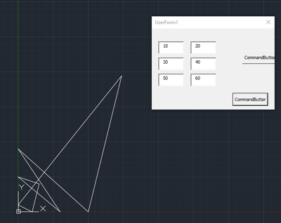

Set plineObj = ThisDrawing.ModelSpace.AddLightWeightPolyline(pt)
plineObj.Closed = True
End Sub
First of all, it's useful to use the same variable for coordinates, in order to avoid confusion, so I used getpoint return coordinates into pt variabile and then I used the same pt array variable with Redim Preserve option in order to maintain the coordinates obtained from Getpoint and assign text boxes contents for other array variable rows.
Delete all previously declaration and insert only Dim pt() As Double:
'Dim pts(0 To 5) As Double
'Dim Point(0 To 11) As Double
As second issue, the AddLightWeightPolyline require the coordinates array sized as multiple of three, otherwise you got an error, this is the reason due to I sized the array 0 to 15.
Finally I don't understand pts(4)  and  pts(5) so I inserted some random number, I guess they are coming from some other parts of code, in case check the declaration method.
See above the image result.
Message 14 of 18

Hi sorry to confuse the situation, what I want to do is basically is to make a shape its not 90 degree  and to place it  anywhere on  screen with the getpoint 1st picture I don't want it to snap back to  0,0 which it keeps doing Second picture hope that makes sense

I'm very sorry, after further investigation the coordinates of a lwpolyline are 2D not 3D as I wrote.
Here below an example of closed polyline with getpoint, please note that you can input data directly on getpoint pointer if you need.
Sub Example_AddLightWeightPolyline()
    ' This example creates a lightweight polyline in model space.
    Dim plineObj As AcadLWPolyline
    Dim points(0 To 7) As Double
    ' Define the 2D polyline points
    pt = ThisDrawing.Utility.GetPoint(, "Pick lowerleft Corner")
    points(0) = pt(0): points(1) = pt(1)
    points(2) = 1: points(3) = 2
    points(4) = 3: points(5) = 2
    points(6) = 3: points(7) = 1
    ' Create a lightweight Polyline object in model space
    Set plineObj = ThisDrawing.ModelSpace.AddLightWeightPolyline(points)
    ZoomAll
End Sub
So this should really works.
