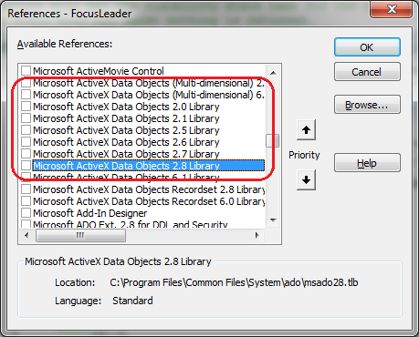

Is there any way to connect the access of office 2010, using the vba in the civil 3dcad autocad 2016 64bits?
If it exists, how to do since the ado component is not shown in the vba reference list?

When you say "connect to (MS) Access..." you need to be more specific: connecting to MS Access application (COM automation, MS Access install is required), or connect to the *.acdbx/*.mdb file (for data only)? Let's assume your case is the latter.
ADO (Microsoft ActiveX Data Object 2.x) comes with Windows OS (both 32-bit and 64-bit). And you should see them in AutoCAD/Civil (64-bit) VBA's "Referneces" dialog box:
Since your AutoCAD is 64-bit, you must download/install MS Access DB Engine 64-bit from MS, which is very tricky/difficult if the computer has 32-bit MS Office installed. In many cases, it might be worth of the effort. Or, you have the computer install 64-bit MS Office (if MS Office is required by the user).
